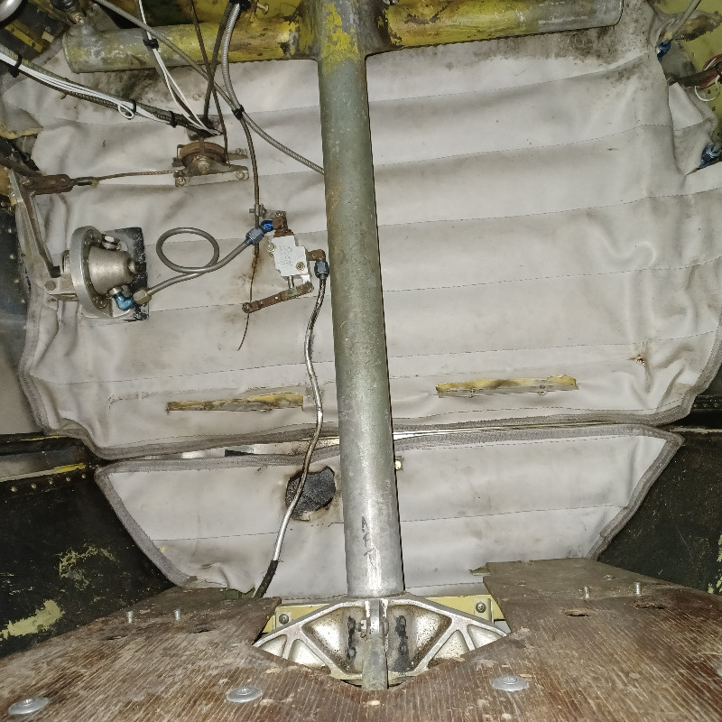

That really is interesting! The hand brake has somewhat familiar pulley setup, but the master cylinder and parking brake are completely different. I see why you were interested in moving the toe board forward... you don't have much behind there!
In my brake pedal setup, the parking brake is dead simple - no valve or plumbing... just a cable that keeps the brake pedal pressed for you.

Hey Brooks,
Apologies for the delay. On firewall you can see the brake cylinder in the upper left corner. Brake lever is on left side of it pointing up and you can see the cable to the panel with the pulley. Smaller shinier object to the right (next to the column) is the parking brake control.

Found out yesterday the brake master cylinder is up above the feet on the firewall and is not the one in the parts manual. So this means I'll have to keep the hand brake on the panel and wait and order the brake pedal cylinder.
