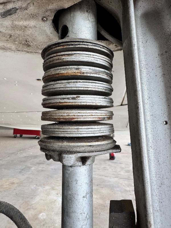

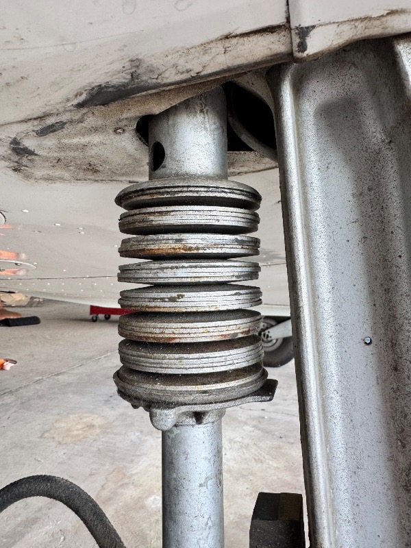

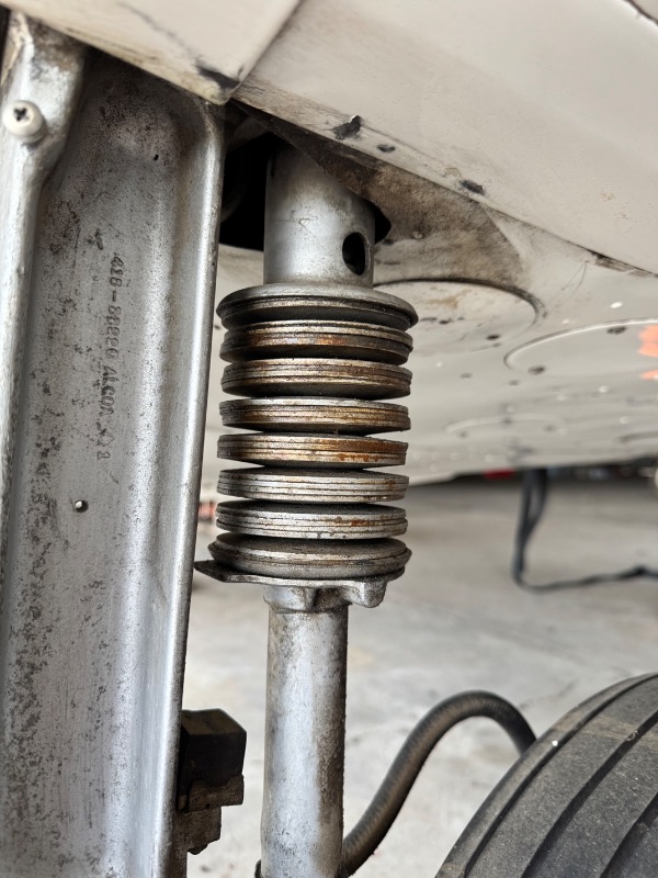

I used the Alpha Aviation spacers with my Bellville-Spring MLG and they worked perfectly.

That certainly would work. I would reach out to Vernon Gregory (he has ads in every Coupe Capers) or try him via email at: vgregoryg (at) aol (dot) com

Just took ownership of Alon A2 N6566Q and have lots of questions. Looks to have Belleville springs rather than donuts. Tail height is at 67.5”. I have 5” nose wheel tire. Canopy sill is not level. Do I add spacers to increase tail height?
