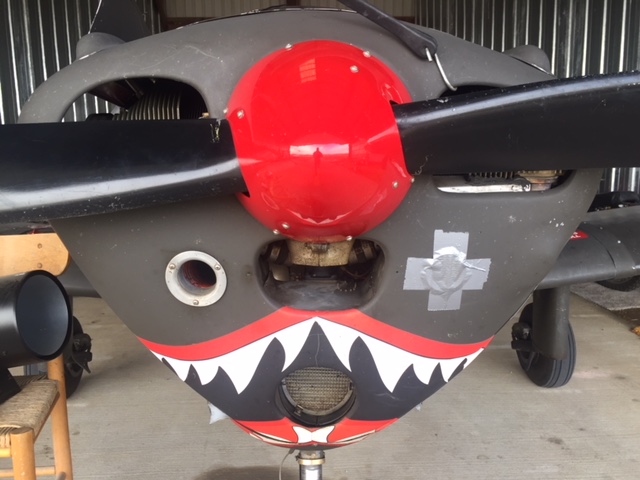

Well....... As it turns out, if you look closely at the pic, there are little holes on either side of the big oval center hole under the spinner. They are backed with nut plates. Looks like someone in this poor plane's long past put SOMETHING over that hole which has long since been lost.
So, I took Larry's very helpful Skyport engineering drawings and enlarged them on my printer enough so that the resultant size just overlapped those holes, traced it onto a 0.040/30 piece of scrap aluminum stock, and cut it out on the band saw. Screwed it in place with lock washers and now the oil temp comes off the peg in anything over about 20 deg OAT. The cabin heater works better too.
Thanks again Larry for your help. Anyone else need the template let me know and I'd be glad to mail a copy for the usual fee of $5000
Actually, it's free and I'll even pay for the stamp.

Thanks Larry. That'll be a big help, even if for no other reason I know what hole to plug up now.
Chris
