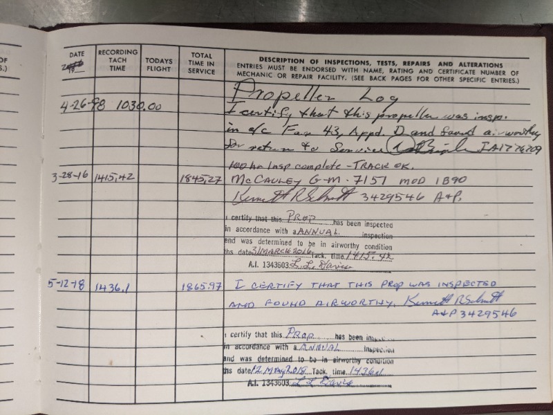

Thank You! I had forgotten about that with Part 91 flying. The only entries regarding the propeller are on the attached logbook page. I guess I am more concerned about corrosion than anything else. The HD pictures I have of it show it to be in excellent condition. I believe that this is the same propeller that was on the plane when it came off the production line. I do not have the SN, so I really have no way to tell at this moment. Thank you again for your assistance.

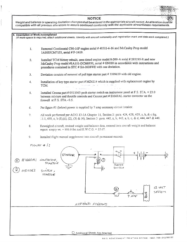

John - I'd love to see a copy of the field approval you have for that prop. Any chance you can snap a pic and either post here or text it to me?
- Posts: 219
15 Oct 2025 09:00 #4
Replied by John Jones on topic McCauley 1B90/CM7151 Propeller Overhaul
I had a similar decision to make last year. My McCauley propeller was installed in 1994 and had almost 2000 hours on it. I decided to send it to a prop shop for inspection and refinish. I guess I'm glad I did because it failed the inspection due to corrosion in the bolt holes. Unfortunately it took almost a year to get a replacement due to lingering Covid supply chain issues. In my case I needed a DCM69/50 to comply with an O-200 field approval installation, or find a different O-200 propeller and get that field approved. I couldn't find either option, new or used, so waited for McCauley to make one.
